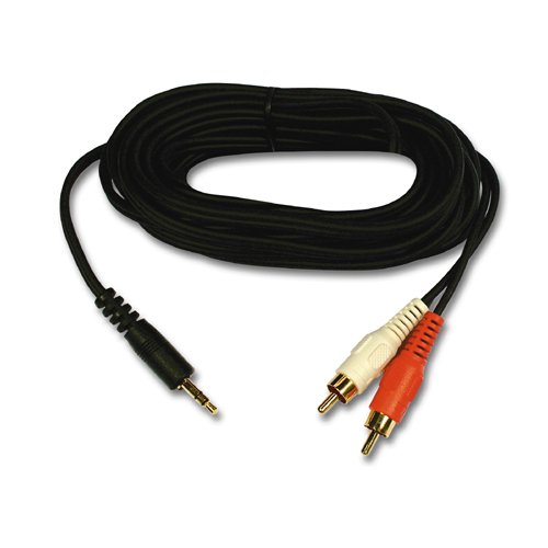

Ok, having looked at the picture of the connections in your Toshiba, it appears that the RCA sockets (red & white) are INPUTS & not OUTPUTS. So it won't be possible that way.
You have 2 options:
1) Connect your TV to your receiver via Digital Audio out port in your TV.
2) Connect your TV via headphone jack using jack to RCA cable.
__________________

Thanks for that.;
1) I don't see an audio out socket on tv - can you?
2)  I guess this means finding a lead with headphone jack on one end and red/white plugs on the other (excuse me if I'm being simple here).

1) It's the Digital audio port next to HDMI 3. Use this cable.
Connect it to "Digital Optical In" in your Denon.
2) Yes, you're correct.

How many speakers have you got? Bear in mind that with RCA, you'll get only stereo sound. Use Digital Audio for Dolby 5.1 surround sound.
